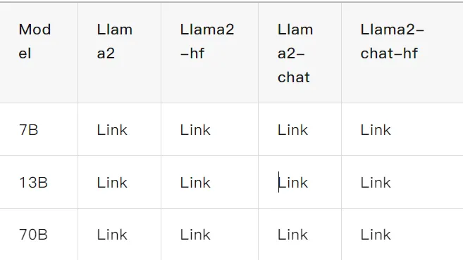

Base ModelPythonInstruct7Bcodellama/CodeLlama-7b-hfcodellama/CodeLlama-7b-Python-hfcodellama/CodeLlama-7b-Instruct-hf13Bcodellama/CodeLlama-13b-hfcodellama/CodeLlama-13b-Python-hfcodellama/CodeLlama-13b-Instruct-hf34Bcodellama/CodeLlama-34b-hfcodellama/CodeLlama-34b-Python-hfcodellama/CodeLlama-34b-Instruct-hf 申请模子
申请地址 https://ai.meta.com/resources/models-and-libraries/llama-downloads/

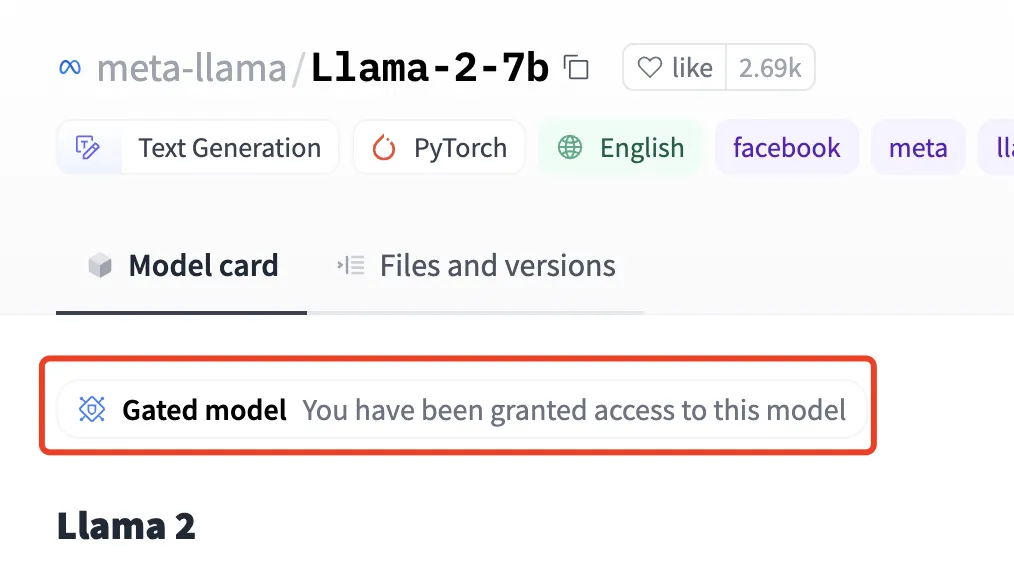

申请通过后,在 hugging face 上如果邮箱同等,会提示已经授权
