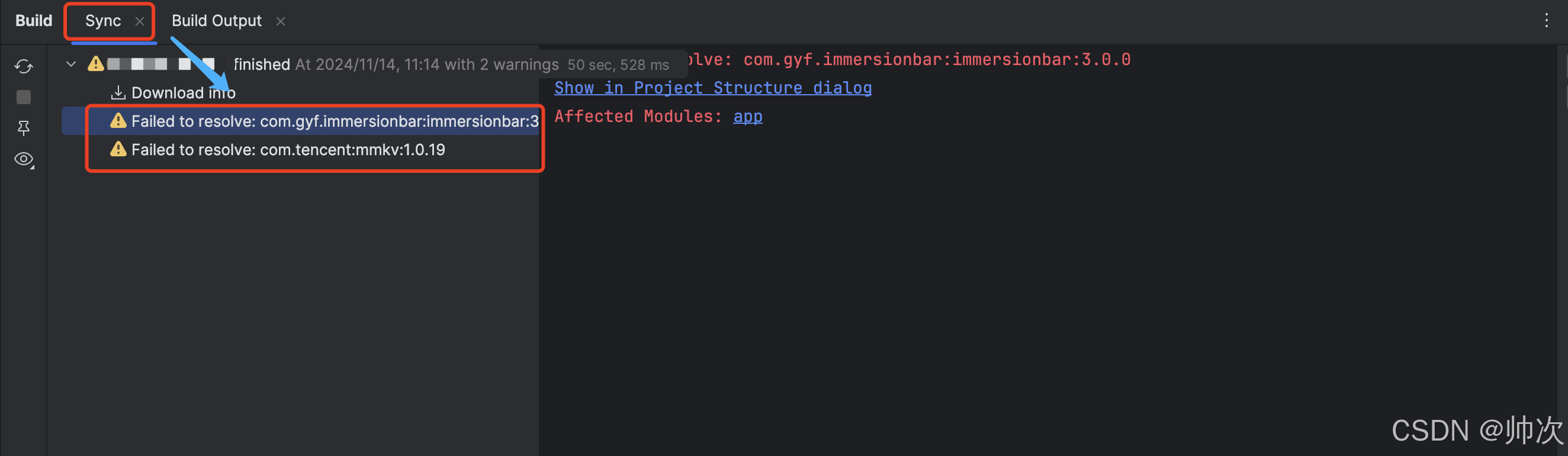

        最近,我在编译一个 Android 老项目时遇到了一个问题,错误信息表现无法找到 com.gyf.immersionbar:immersionbar:3.0.0 这个依赖。经过一些排查和调试,我找到了几种解决方法,本日就来分享一下如何解决这个问题。

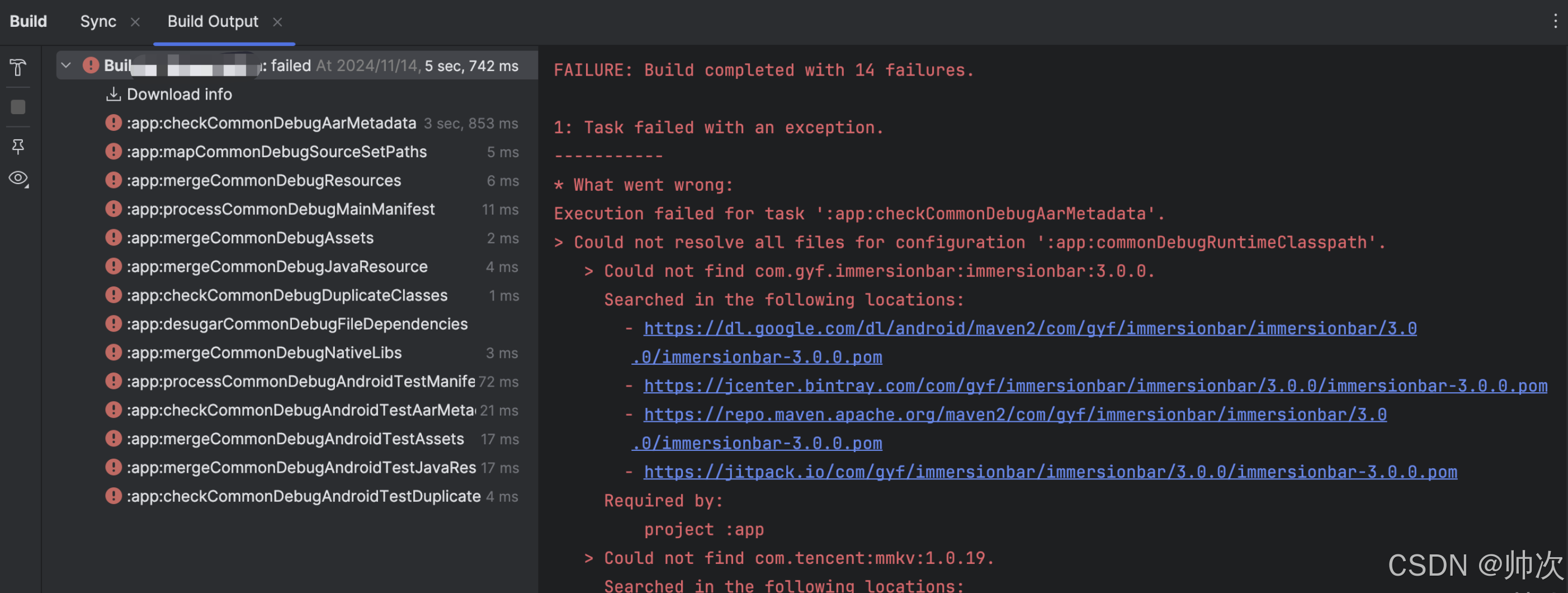

错误信息剖析
  1. FAILURE: Build completed with 14 failures.
  2. 1: Task failed with an exception.
  3. -----------
  4. * What went wrong:
  5. Execution failed for task ':app:checkCommonDebugAarMetadata'.
  6. > Could not resolve all files for configuration ':app:commonDebugRuntimeClasspath'.
  7.    > Could not find com.gyf.immersionbar:immersionbar:3.0.0.
  8.      Searched in the following locations:
  9.        - https://dl.google.com/dl/android/maven2/com/gyf/immersionbar/immersionbar/3.0.0/immersionbar-3.0.0.pom
  10.        - https://jcenter.bintray.com/com/gyf/immersionbar/immersionbar/3.0.0/immersionbar-3.0.0.pom
  11.        - https://repo.maven.apache.org/maven2/com/gyf/immersionbar/immersionbar/3.0.0/immersionbar-3.0.0.pom
  12.        - https://jitpack.io/com/gyf/immersionbar/immersionbar/3.0.0/immersionbar-3.0.0.pom
  13.      Required by:
  14.          project :app
  15.    > Could not find com.tencent:mmkv:1.0.19.
  16.      Searched in the following locations:
  17.        - https://dl.google.com/dl/android/maven2/com/tencent/mmkv/1.0.19/mmkv-1.0.19.pom
  18.        - https://jcenter.bintray.com/com/tencent/mmkv/1.0.19/mmkv-1.0.19.pom
  19.        - https://repo.maven.apache.org/maven2/com/tencent/mmkv/1.0.19/mmkv-1.0.19.pom
  20.        - https://jitpack.io/com/tencent/mmkv/1.0.19/mmkv-1.0.19.pom
  21.      Required by:
  22.          project :app > com.gitee.zhang-yanqiang:easypermission:v2.0.12
  23. * Try:
  24. > Run with --stacktrace option to get the stack trace.
  25. > Run with --info or --debug option to get more log output.
  26. > Run with --scan to get full insights.
  27. ==============================================================================
        从错误信息中可以看出,Gradle 无法在常见的 Maven 仓库中找到指定版本的 immersionbar 依赖库。具体的错误是它无法剖析 com.gyf.immersionbar:immersionbar:3.0.0,说明该依赖在指定的仓库中不存在,大概设置出现了问题。
