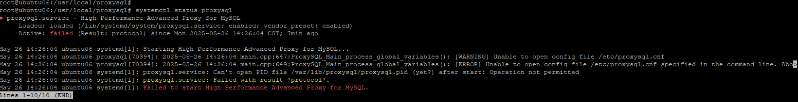

原本想用编译安装的,编译了30多分钟,启动的时候提示无法打开设置文件,无语了,只能用deb包安装

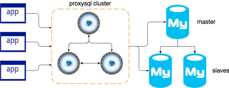

proxysql原理:
proxysql.cnf 中的设置只在初次启动 proxysql 时生效。假如 proxysql 的内置数据库已经创建,后续只会从内置的数据库中读取设置信息,这时再修改 proxysql.cnf 就不起作用了。

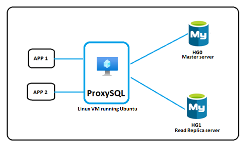

MySQL主从复制
mysql 主:192.168.152.112:8000
mysql 从:192.168.152.113:8000
proxysql1 192.168.152.112:6032
proxysql2 192.168.152.112:6032

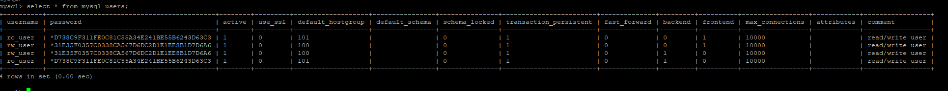

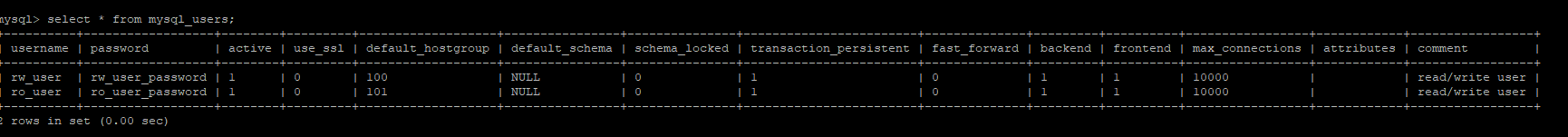

  21. mysql> select * from mysql_users;
  22. +----------+------------------+--------+---------+-------------------+----------------+---------------+------------------------+--------------+---------+----------+-----------------+------------+-----------------+
  23. | username | password         | active | use_ssl | default_hostgroup | default_schema | schema_locked | transaction_persistent | fast_forward | backend | frontend | max_connections | attributes | comment         |
  24. +----------+------------------+--------+---------+-------------------+----------------+---------------+------------------------+--------------+---------+----------+-----------------+------------+-----------------+
  25. | rw_user  | rw_user_password | 1      | 0       | 100               | NULL           | 0             | 1                      | 0            | 1       | 1        | 10000           |            | read/write user |
  26. | ro_user  | ro_user_password | 1      | 0       | 101               | NULL           | 0             | 1                      | 0            | 1       | 1        | 10000           |            | read only user |
  27. +----------+------------------+--------+---------+-------------------+----------------+---------------+------------------------+--------------+---------+----------+-----------------+------------+-----------------+
  28. 2 rows in set (0.00 sec)

proxysql自身假如是单点状态,同样会存在风险,因此proxysql自身也需要做一个cluster,proxysql自身作cluster比力简单。

  21. --自动同步proxysql1(192.168.152.112:6032)上的信息
  22. mysql> select * from mysql_users;
  23. +----------+-------------------------------------------+--------+---------+-------------------+----------------+---------------+------------------------+--------------+---------+----------+----------------
  24. | username | password                                  | active | use_ssl | default_hostgroup | default_schema | schema_locked | transaction_persistent | fast_forward | backend | frontend | max_connections
  25. +----------+-------------------------------------------+--------+---------+-------------------+----------------+---------------+------------------------+--------------+---------+----------+----------------
  26. | ro_user  | *D738C9F311FE0C81C55A34E241BE55B6243D63C3 | 1      | 0       | 101               |                | 0             | 1                      | 0            | 0       | 1        | 10000
  27. | rw_user  | *31E35F0357C0338CA567D6DC2D1E1EE8B1D7D6A6 | 1      | 0       | 100               |                | 0             | 1                      | 0            | 0       | 1        | 10000
  28. | rw_user  | *31E35F0357C0338CA567D6DC2D1E1EE8B1D7D6A6 | 1      | 0       | 100               |                | 0             | 1                      | 0            | 1       | 0        | 10000
  29. | ro_user  | *D738C9F311FE0C81C55A34E241BE55B6243D63C3 | 1      | 0       | 101               |                | 0             | 1                      | 0            | 1       | 0        | 10000
  30. +----------+-------------------------------------------+--------+---------+-------------------+----------------+---------------+------------------------+--------------+---------+----------+----------------
  31. 4 rows in set (0.00 sec)
这里有一个细节:mysql.user表在proxysql1(192.168.152.112:6032)上明文,在proxysql2(192.168.152.113:6032)上是密文
